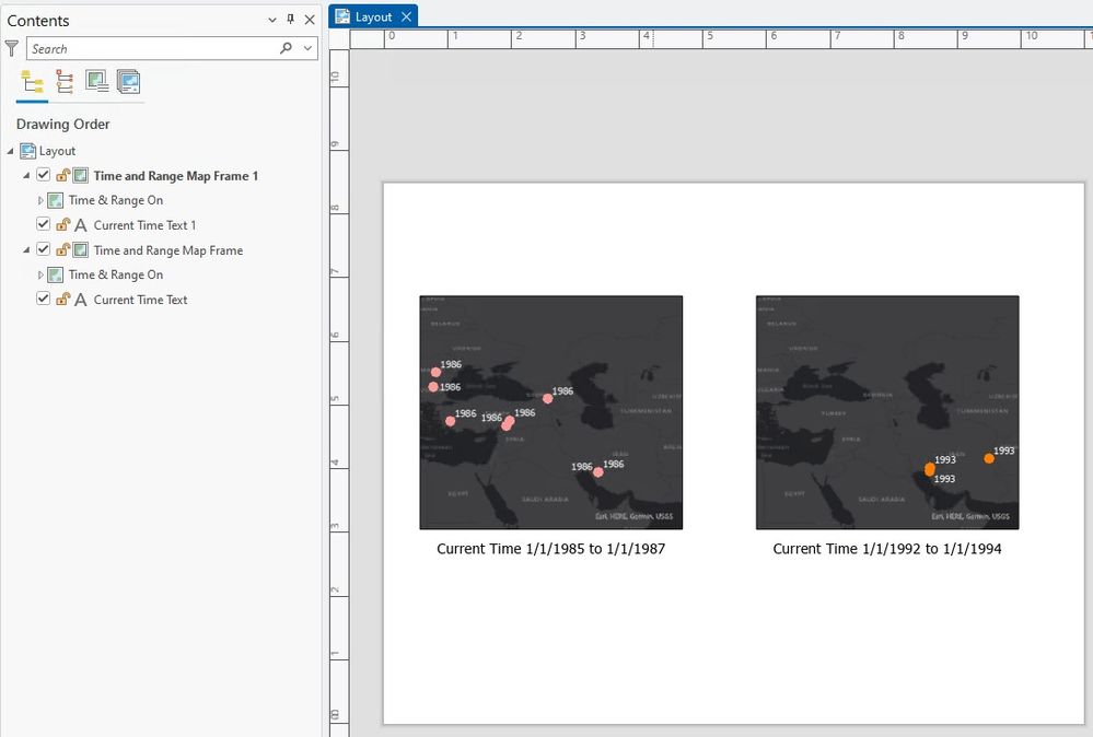

By "panel" I'm assuming the you are talking about Map Frames. You can have any number of Map Frames on a layout with all Map Frames referencing a single map. Each map frame can show a different spatial extent of the map. You can do this by selecting each map frame and setting a different map scale. Or, you can activate the map frame and use the navigate tool to zoom and pan to the extent you want.
Through map frame activation you can also set a time (or range) value for the map frame. In the screenshot below I have 2 map frames that point to the same map showing earthquake point data symbolized by year. Both map frames show the same spatial extent. The map frame on the left shows earthquake points between the years 1985 and 1987. The right map frame shows earthquake points between the years 1992 and 1994.

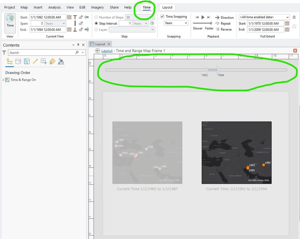

Much like setting a different spatial extent the time range shown in a map frame can be set by activating the map frame (select map frame, left click to open context menu and click Activate) and using the Time Slider or the Time commands on the ribbon to set the time properties for the map frame. These settings will be independent of other map frames or map views of this map.
When you state "... when I select a different time-period query for each panel, it applies the changes to all the panels..." I'm not sure what steps you are taking to do this. What exactly do you mean by "time-period query"? Any query (ex: Definition Query) set on a layer will propagate, like layer symbology, to all map frames and map views. This is expected.
