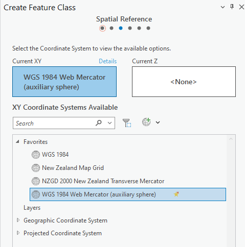

Is there anyway to set the default coordinate system for creating new feature classes.  In NZ we only have one coordinate system for the whole country.  Well there are heaps - but only one main one. As such I would like it to default to New Zealand Transverse Mercator when I create a new feature class.

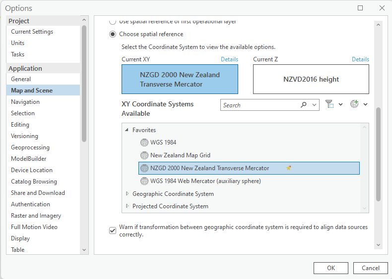

I currently have NZTM set as default for my maps (see below) but this doesn't seem to flow through to the Create Feature Class process.  Although I swear it used to.  I feel like this has just changed with 3.3.1?
