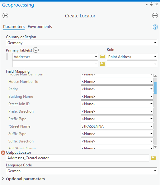

I'm on AGP 2.7 trying to create a Locator using the Geocoding tool "Create Locator".
But no matter what name I put into the Output Locator field (even the default one I get when I first select the primary table) I only get
ERROR 002777 The name is invalid.
I tried using only letters, various forms of lower or upper case with or without numbers but I can't find a name that the tool will accept as valid.
Any help is appreciated.

What's the full path of the output?
Please ensure there is no space, special characters or accented characters in any of the folders as well.

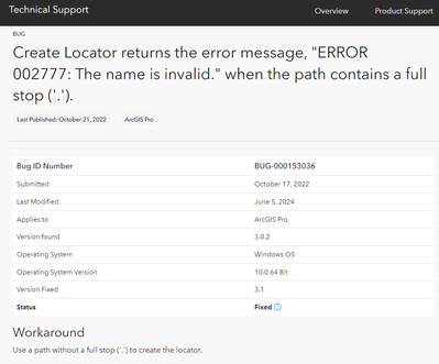

AllenDailey1
I have been having this problem, and I found this bug documentation from Esri:
https://support.esri.com/en-us/bug/create-locator-returns-the-error-message-error-002777-t-bug-00015...
My path does have periods in it, in the server name, which includes "name.dmz".  So I guess that's the problem.  The bug was found in Pro 3.0.2 and fixed in 3.1.  I am using 3.0.3.  Time to upgrade!
