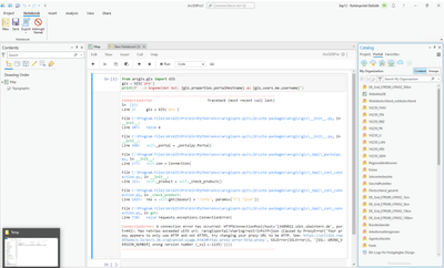

I want to connect to my portal in ArcGIS Pro within a Jupyter Notebook using command arcgis.gis.GIS('pro') . This works fine in ArcGIS Pro 2.9 (screenshot 1 below). If I try the same thing in ArcGIS Pro 3.0, an error message appears (screenshot 2 below).
ConnectionError: A connection error has occurred: (Caused by ProxyError('Your proxy appears to only use HTTP and not HTTPS, try changing your proxy URL to be HTTP. See: https://urllib3.readthedocs.io/en/1.26. x/advanced-usage.html#https-proxy-error-http-proxy', SSLError(SSLError(1, '[SSL: WRONG_VERSION_NUMBER] wrong version number (_ssl.c:1129)'))))
Does anyone know anything here
Best regards
Armin
ArcGIS Pro 2.9 works fine
ArcGIS Pro 2.9 worksArcGIS Pro 2.9 works
ArcGIS Pro 3.0 command fails
ArcGIS Pro 3.0 errorArcGIS Pro 3.0 error
