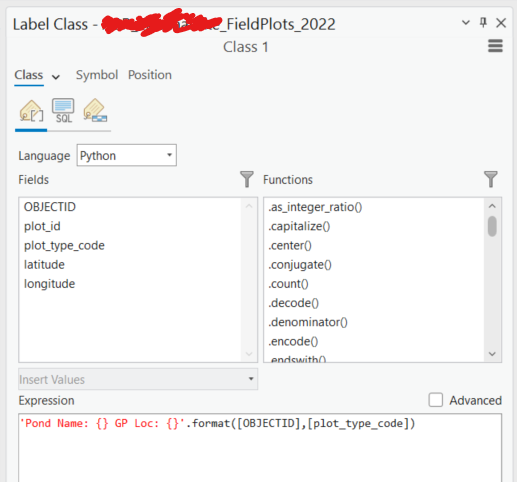

2) Label based on the GP field.  Consider a Label Expression similar to below in EXPRESSION box.
Note that below label expression you will replace "Pond Name" and "GP Loc" with whatever text you want.  You will also replace fields [OBJECTID] and [plot_type_code] with [<pond_name_field>] and [<GP_name_field>].  FYI - the syntax <pond_name_field> means "replace with the field name of pond from att table".  Ditto for <GP_name_field>.
SEE the labels on map screenshot?
Good luck!
