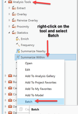

In fact, you can batch the tool to produce results for multiple featureclasses...

BTW, your suggestion to go with the batch option in in the tool box panel works very well - thank you!!
