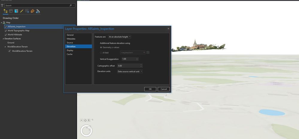

Any insights into this? I have the same problem: slpk model is hovering above ground/terrain in ArcPro.
I cannot alter/change the elevation information of the .slpk  file (right click>properties>elevation).
Oddly in AGOL the model sits on the ground correctly (that is partly because absolute height can be edited and is at 0).

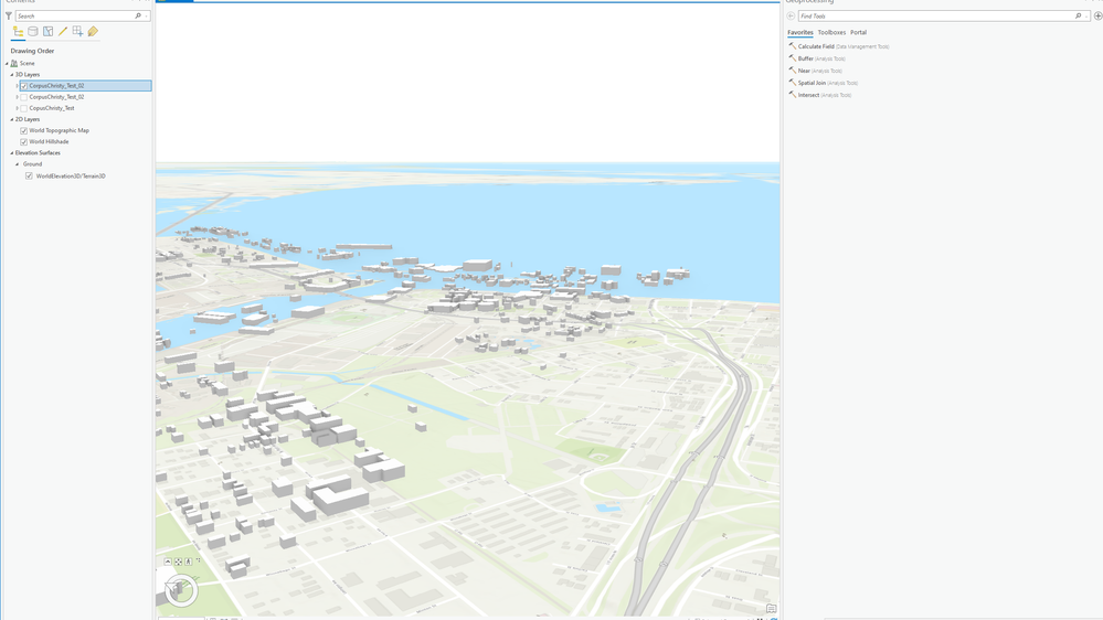

We are having the same issue where we have created a 3D building layer but we cannot get it to properly align with altitude. It is 500 ft above "zero" (see attached). image (13).pngimage (13).png

So there were two issues contributing to this problem.
1) This mesh was created in Blender using a GIS plugin, https://www.youtube.com/watch?v=n_TbwtJnhAw. This did a good job creating the building masses from a 2D map however, I suspect the output imbedded a location node that was not at 0,0,0. To fix this I copied the geometry and pasted it into a new Mesh Object (Modo) and then reset all the pivot points (Item>Transforms>Zero All).
2) You have to ignore the 'apparent position' of the geometry when importing into ArcGiSPro. It seems, regardless of the pivot/center point position ArcGiSPro places bottom of the 3D models at the ground surface. For instance, if you import a box with the pivot in the center and then import into ArcGiSPro the box will 'sit' on the ground plane (pivot above the ground plane). This will mislead you into thinking that your model is set up correct but if you then create a .slpk file and bring this into your editor (Unity) the box will be imbedded into the ground (ie, the pivot center will be at 0 in the up-axis). So, make sure the center/pivot of your 3D object is at the bottom of the geometry.
Hope this helps 🙂
