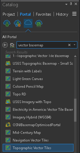

I would recommend you two things.
  • Report this to Esri Nederland, since I do notice a difference in quality between exporting the layout and exporting the map frame
  • Use the Topographic Vector Tile basemap
Using a vector tile base map really gives a much better quality of the output PDF (here zoomed in to 200% or the PDF):
GISTeam4
Hi Xander,
The vector basemap (only world topographic one) works a treat, very true. It's a shame that the beautiful topographic one combined with height for Holland (RD, ESRINL) does not. I tried searching basemap, vector. This RD one pops up but doesn't load, i suspect there are a few around. This last map is very useful when mapping terrain, which is what we do most. So it seems that despite al the fun and beautiful developments we still can't use the basemaps we want to on a regular and steady basis. Which is a real shame. But ah well, thanks for your tip on vectors!

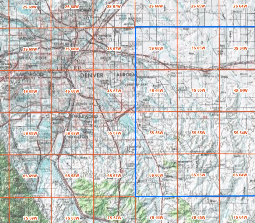

I am having the same exact very frustrating problem. Exporting a layout to PDF results in very poor quality basemaps in the PDF. I have exported with various basemaps, both raster and vector, with varying dpi and image quality with no success. I have attached screenshots of what I am seeing below. Exporting with "Best" image quality results in a better quality PDF but increases the size of the PDF to from 1,843 KB (Normal) to 10,844 KB (Best).
I am using ArcGIS Pro 2.2.4
300dpi & Best Image Quality with Raster Basemap
600dpi & Best Image Quality with Raster Basemap
600dpi & Normal Image Quality with Vector Basemap
File Sizes
I have read the above suggestion from Liedeke Reitsma but I recently had to reinstall windows on my computer and install a clean version of ArcGIS Pro so I don't think this would solve the problem.
