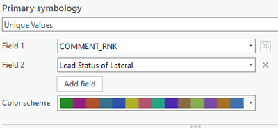

I am wondering if there is a way to filter only AGOL compatible symbology for webmaps. According to the documentation (FAQ: What are the symbology considerations when publishing to ArcGIS Online? (esri.com) ) What I published should be working, but it is not coming through. - This is published directly from my Pro (3.0.2) to AGOL organizational account using 2 attributes.

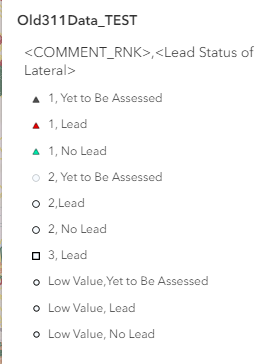

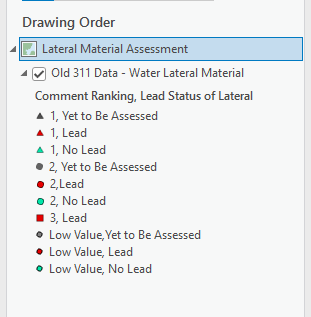

  Below are the two differences in symbology.
And WebMap viewer doesn't give me the option of changing the symbology... maybe because it is using 2 attributes for the symbology? Not sure. I am going to continue to tinker, but I feel like I might be missing a key piece of information that makes accomplishing this easier.

The documentation here goes in depth on what is not supported in feature layers: 24082: Layer's symbol will be downgraded—ArcGIS Pro | Documentation. I believe "unique value symbology based on multiple fields" is your problem, though I do not know why some points and not others were changed.
I do not think there is a way to filter out symbology not supported in feature layers. However, one way to get around this is to share your layer from Pro as a Web Map rather than a feature layer. You have to uncheck the box "Use symbol types compatible with all clients." Then, Pro will create a feature layer, put it on a web map, and use the symbology you selected in Pro. The layer will only be symbolized that way on the individual web map. If you add the feature layer to another web map, it will have the downgraded symbology. Share a web map—ArcGIS Pro | Documentation

Also - another fun quirk, the symbology is working on the web map correctly, but not in the web map legend. So I may be able to get by with it since it is for an internal assessment and not for the public.
