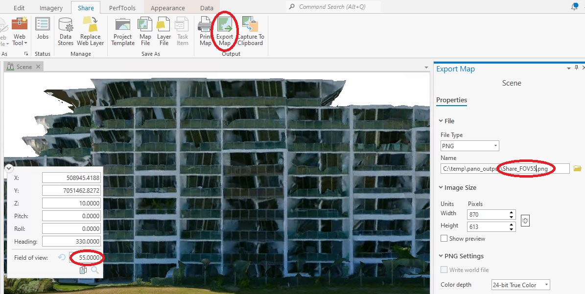

1. Have a 3D scene ready with Camera settings at your required view point. Leave FOV at 55. In the Share tab choose Export Map and export it using the Export Map pane.

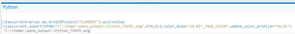

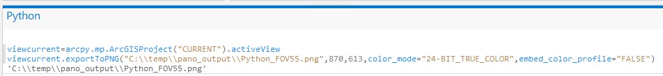

2. Export the same scene using Python:

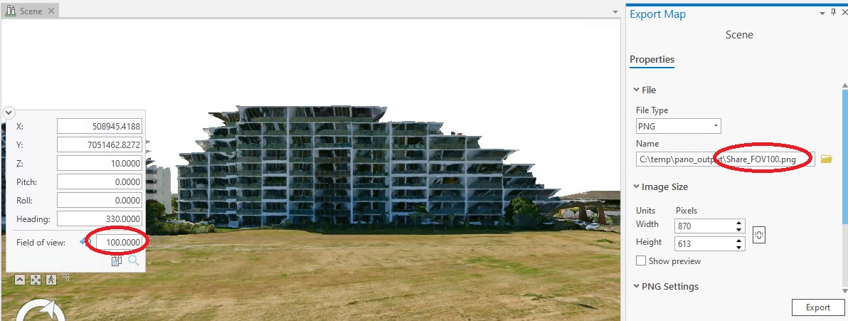

3. Change the Field of View to 100. Export the scene using Export Map again.
4. Now export using Python.

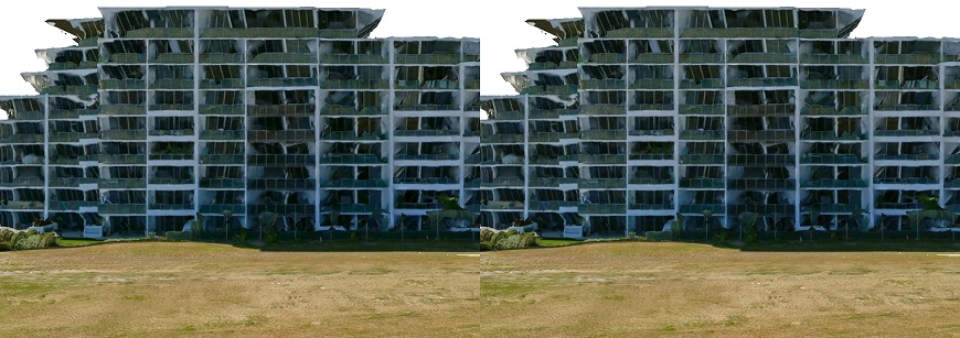

Checking the outputs, here are the FOV55 outputs side by side. Export Map on the left and Python on the right. They are the same.

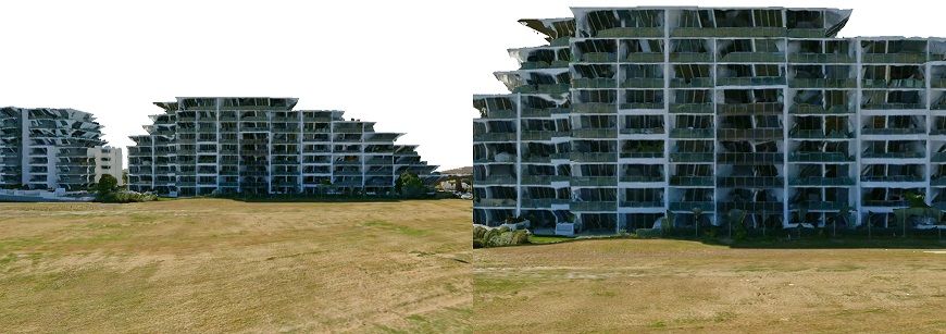

And here are the FOV100 outputs. The Export Map on the left has been output using the correct FOV, but Python on the right is still using FOV55.
