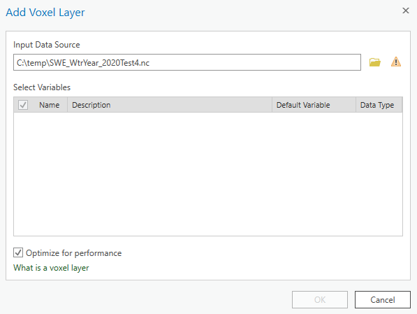

I have created a netCDF file using the tool "Create Space Time Cube From Defined Locations.  The tool executes without issue and the file is created.  However, when I try to add the netCDF voxel to my Pro session's local scene through the "Add Data" control, the Add Voxel Layer dialog that allows variable selection does not present any variables to select.
If I try to drag the file from windows explorer to the scene, a message box appears stating "Failed to add data, unsupported data type"
I have previously used the tool "Create Space Time Cube by Aggregating Points" and was able to successfully bring in the netCDF voxel.  Not sure if the the "Create Space Time Cube From Defined Locations" version is too large as the point feature class it was created from contains slightly over 6 million points.
I am able to successfully create a point feature class from the .netCDF file that I use in another application, so it would seem the netCDF file is healthy.
Any insights as to why Pro won't bring this netCDF file create from the defined locations tool into a local scene would be appreciated

When this happens it means the netCDF is not regularly gridded or is volumetric. You can click the warning button in the dialog to get more details. Based on the difference between these two tools it looks like the Create Space Time Cube by Defined Locations will not work because it will output an irregularly gridded dataset that cannot be used as a voxel layer. I would use the Create Space Time Cube by Aggregating Points tool instead.
https://pro.arcgis.com/en/pro-app/latest/help/mapping/layer-properties/voxel-layer-freqently-asked-q...
https://pro.arcgis.com/en/pro-app/latest/help/mapping/layer-properties/create-a-voxel-layer.htm#GUID...
