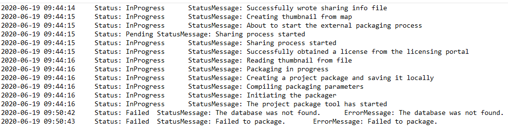

I am packaging a project to a file in PRO.  But the packaging is failing.
I analyse the project before packaging and it does not turn up any errors.
The packaging process runs fine for about 6 minutes and then I get a message "failed to package".
The message log says "the database was not found".  I am unsure what database the error is referring to so am not sure how to move forward.  It's a bit vague.
I have gone through all my maps and everything seems in order.
Is anyone familiar with this problem and how to move forward?
**EDIT**  I have tried to "Upload package to Online account" rather than save as a file.  I also eliminated layers, one by one, to determine if there was a bad file that impeded the packaging.  These did not yield any positive outcomes.  I am still getting a failed message.

Results:
With the same output as described in OP.
