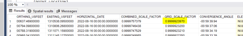

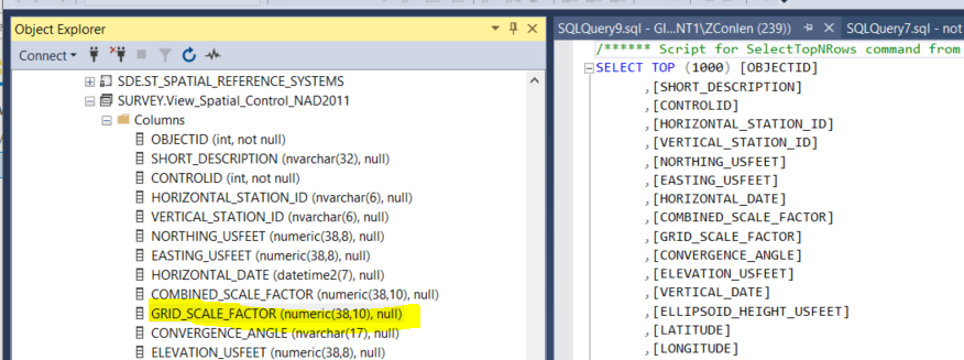

Hi. I'm running into an issue with Pro, where it changes field properties for numeric field types. In the SDE (sql server) table, the field has a scale setting of 10. This indicates that 10 decimal places should be shown after the decimal. Actually, it's a spatial view, but the view properties show scale setting of 10, and 10 digits are shown when previewing the data.

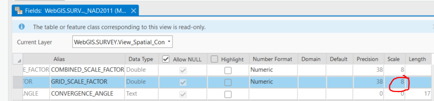

When I add that view to Pro, the scale is shown as 8.

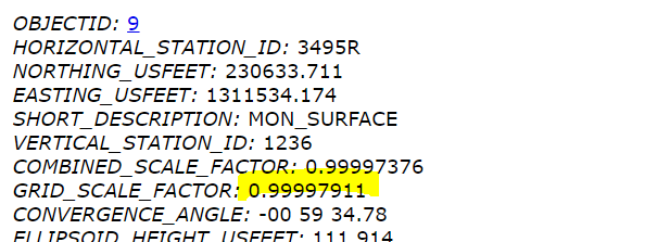

And when I publish it as a map service, only 8 places after the decimal are shown
The upshot is that I can't display the data properly in my web app.

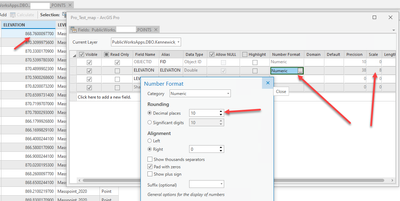

I set up a field in SQL with the same setting (numeric(38, 10)) and see the same thing in Pro.
However, in Fields, you can set the number format and decimal places.  Setting to 10 Decimal Places will show you 10, unless there are zeros, then it will drop them and only show up to 10 places with value.
If you need 10 places regardless of the zeros on the end, use the pad with zeros option.

I found that setting but it does not solve my issue. It appears to be a display setting and is ignored when I publish the map service.
