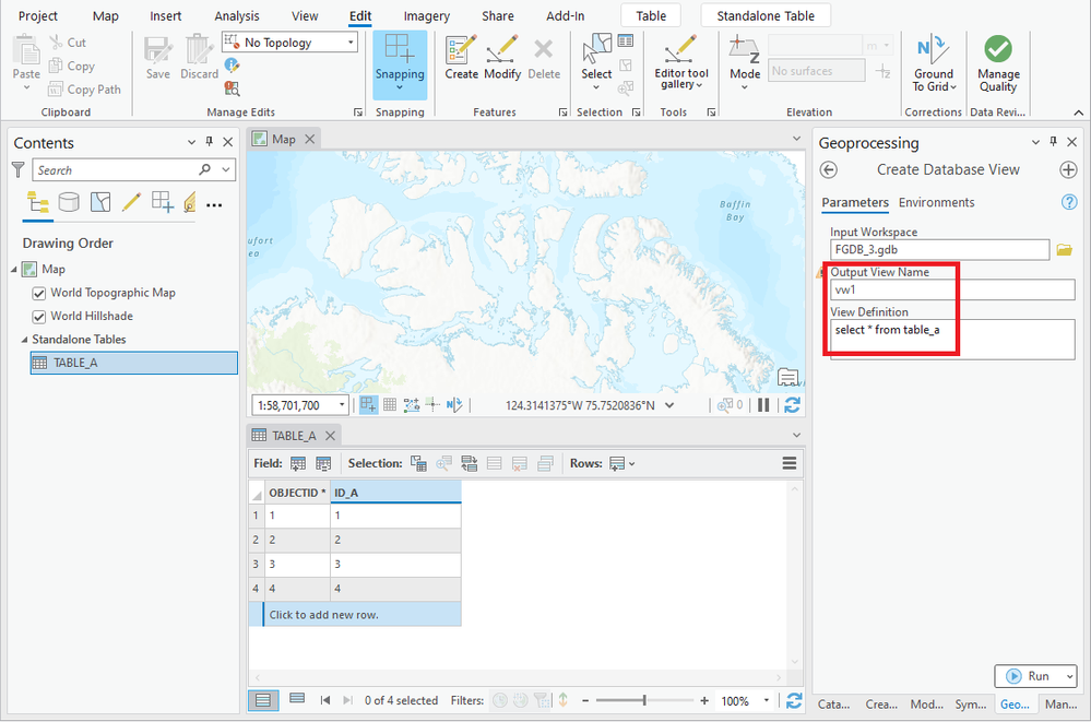

I've created a standalone table in a file geodatabase. And I've created a view on the table:
select * from table_a
The view has been created successfully:

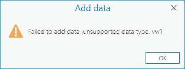

However, when I try to add the view to the map, I get an error:
Failed to add data, unsupported data type. vw1

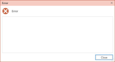

And I can't rename the view. I get a blank error message:
