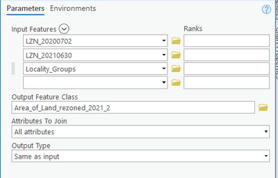

I am Intersecting three feature classes, two of which -  LZN_20200702 and LZN_20210630 - have the same field names.

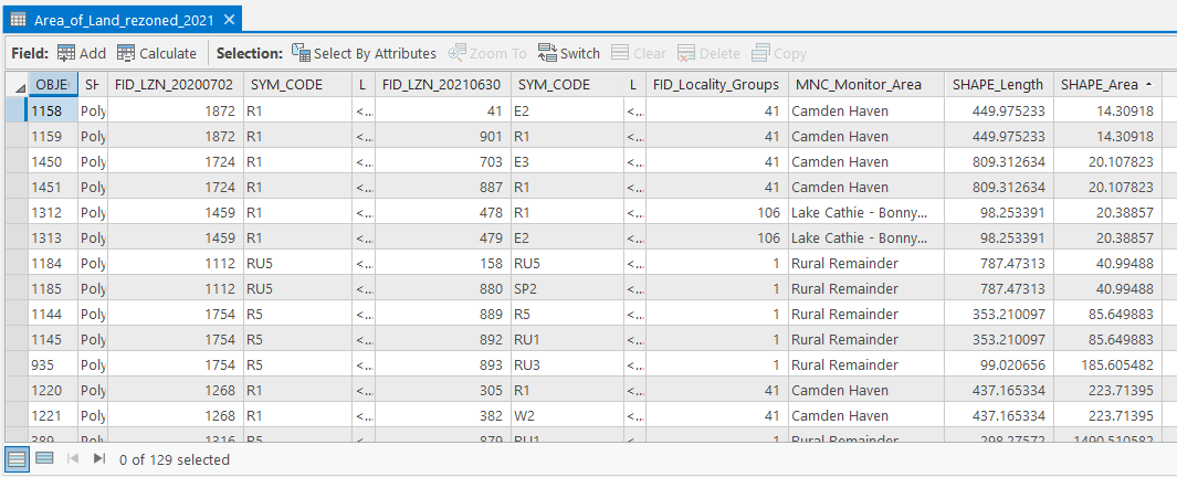

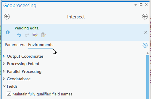

I have ticked the “Fields > Maintain fully qualified field names” but the output is only labelling the FID for each feature class, and not maintaining qualified field names.  I need to know which original feature class the field "SYM_CODE" is from to enable a definition query.

Screenshots of the dialog boxes:
1. The intersect feature Parameter settings
2. Environment settings
3. Resulting fields
