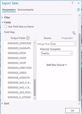

I'm trying to export a .cvs file (in Pro) from a feature layer hosted on ArcGIS Online. The feature layer is used in Field Maps and includes all the GPS metadata fields. It also has several other fields that were added later.
The issue I'm seeing is that when I use Export Features tool (from the contextual menu you get when you right click on a layer in the table of contents) or the Export tool (from the hamburger menu at the top right of the attribute table), I only have the option to export the original fields and the metadata fields. The newer fields (which have still been there for months) are not included in the Fields section of the export dialog boxes and do not get exported with the rest of the data. However, if I use the Table to Excel geoprocessing tool, it exports all the fields.

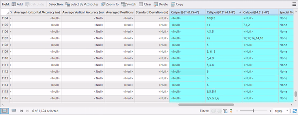

I can see all the fields in the attribute table, and I don't see anything different about the new fields in the Fields View.

This might be a known issue already logged to Esri Support, BUG-000154896.
"In ArcGIS Pro 3.0.3, right-clicking a layer created in ArcGIS Pro 2.8 in the Contents pane to export features does not include all of the fields in the attribute table."
I can determine if it's the same problem, by looking at the layer file, which you can generate by right-clicking the layer, select Sharing>Save As Layer File and email the result to [email protected]. The layer file doesn't contain any sensitive data, only the layer property definitions.
You can also try searching for "Copy Rows" in the geoprocessing pane and use that simplified tool to export the output .csv. The problem above relates to the Field Map parameter of the export tools.
