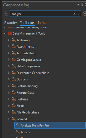

There’s actually a GP tool in ArcGIS Pro called “Analyze Tools for Pro” that can analyze your python scripts to see if they are Python 3/Pro compatible:
When we ran that tool against one of our scripts, the only issues it identified there were the “print” statements… they need to have brackets in Python 3.
