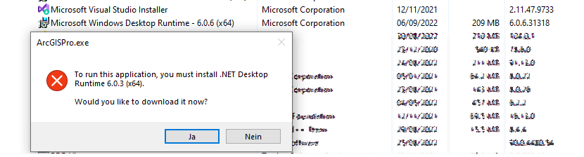

ChristophHoeser
I have donwloaded and installed exactly using the link provided. And did a complete restart.
ArcGis Pro refuses to work.
Well, I will turn to a tool which does not hesitate to do the job: QGIS.
ChristophHoeser
Now I have downloaded and reinstalled/"repaired" complete ArcGis Pro, which was finalized without any complaints. Starting the Programm ist still refused pointing to a missing .NET Desktop - which IS available and installed.
ESRI is unproductive and wasting time.
ChristophHoeser
Now I have de-installed Net Desktop runtime 6.0.6.
Than installed .NET Desktop Runtime 6.0.3, (exactly the version ArcGis Pro claims to be necessary)
Than rebooted the complete computer.
Result: ArcGIS Pro refuses to work,: .NET Desktop Runtime 6.0.3(!) is missing ...
Than installed latest version .NET Desktop Runtime 6.0.8 on top of 6.0.3.
-> ArcGIS Pro is running
ESRI owes me the equivalent of 3 hours of work due to misleading chatter in the tone of command ("... you MUST install...").
