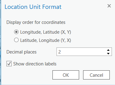

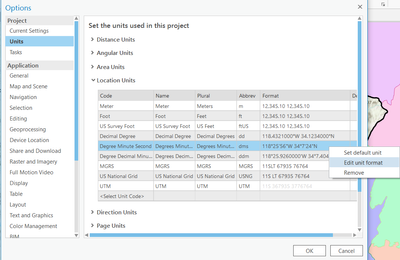

From the location view dropdown
Under Location Units > Right-click on the particular value (Format Column)
Change Decimal places
Ensure DMS is marked as default

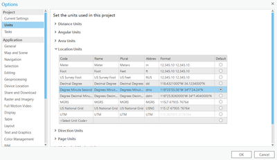

The Format Location Units in the drop down doesn't seem to show up in 2.7.  I can set the DMS units through the options to 2 decimal places, but the coordinate tracker still doesn't and decimals for the seconds.

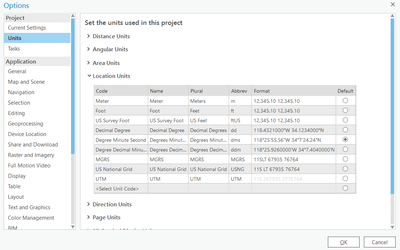

It showed up correctly after a reset.  The unit type changes instantly without restart but apparently precision sometimes needs a program reboot to show up.
