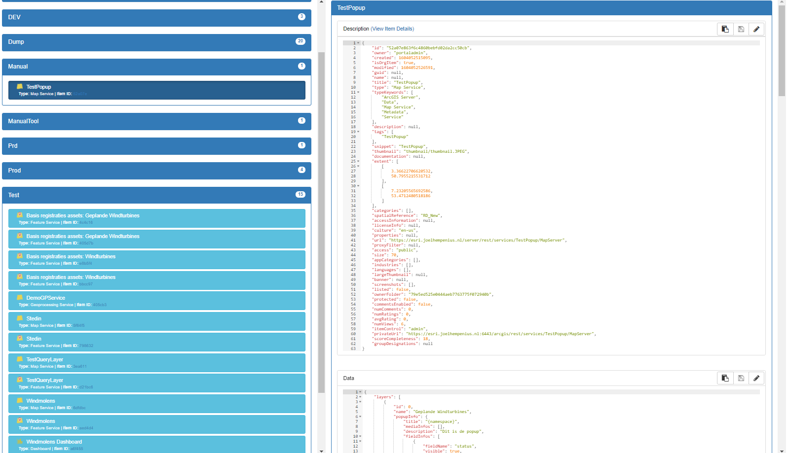

I've automated sharing my mapservices to ArcGIS Enterprise using arcpy and now I see a difference on the configured popups between the services I share manually from Pro and the services I Share using Arcpy. When I share manually, the popup information is also shared in ArcGIS Enterprise and when I configure the mapservice in a new map in ArcGIS Enterprise the popup configuration  is the same as ArcGIS Pro. When I share the service from Arcpy and add the service to a new map in ArcGIS Enterprise, there is no popup configuration and I need to do the popup configuration again in the webmap.
Using Ago-assistant, I dug a little deeper and found the service I shared manually has a data section containing the popup configuration and the service I shared using Arcpy doesn't have this.
Screenshots to illustrate this:
The services shared manually from ArcGIS Pro has the data section bottom right with the popup info:

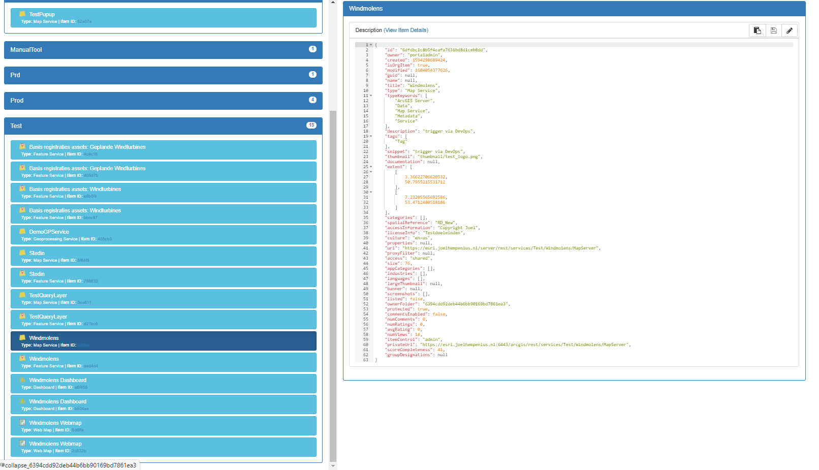

The service shared using Arcpy doesn't show the data item:
From the network tab in dev console I see a /data? request, but this gives a 200OK with 0 content length.

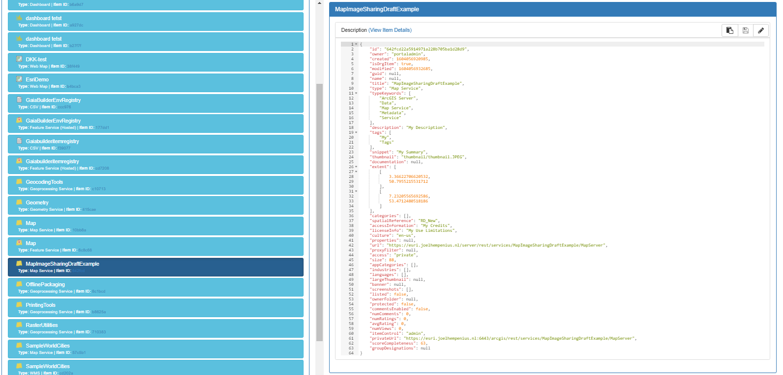

I tried a very minimal script from this page (MapImageSharingDraft—ArcGIS Pro | Documentation )  and modified it only to publish my pro project to my server, but this gives the same result.

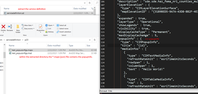

I have inspected the service definition file that is generated in the arcpy publication process and it has the popupinfo section but it is ignored at the upload service definition stage.
unfortunately i was unable publish the service with the popups reflected in the service as i wanted.

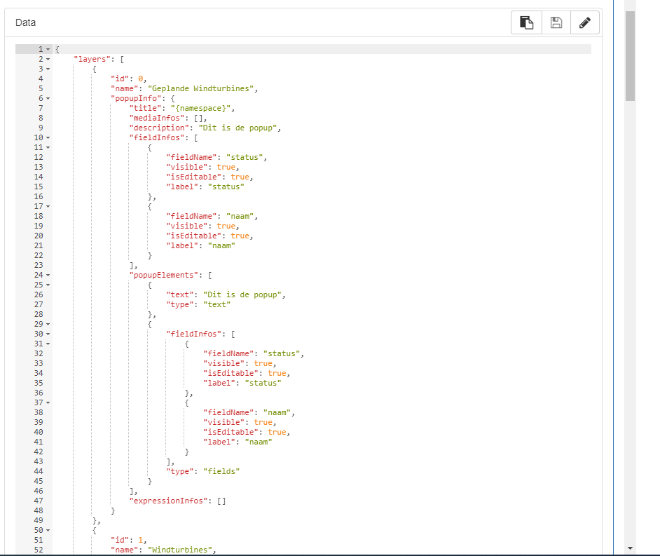

Posting a new data element to an existing portal item is easy using the python api:
given that you have succesfully logged in to your GIS and have the itemid of the mapservice and a portalLogo File path variable and you also want to set the description in Portal for the mapservice:
portalitem = gis.content.get(itemid)
item_properties ={ 'description' :  description}
item_properties['text'] =data
portalitem.update(item_properties=item_properties, data=None, thumbnail=portalLogo, metadata=None)
and the data object should be structured like this, in this case I have two layers with "Allow assignment of unique numeric IDs for sharing web layers" enabled in the map:

I see in content/items folder that there is no JSON file when I use arcpy. Is that what you are talking about here? You are adding it with the "update" method?
If so, where do you get the JSON data that you are adding? I can see you opening up the SD file and there is a mapx file in there.
The mapx does indeed have popupInfo.
Your code sample is opaque to me though. What is this doing? How do I get from a CIM popup to one that can be sent to the service?

AH brilliant! You let PRO generate the JSON, then copy it. I had already published from PRO so I should be able to read the PRO service and then update the arcpy server. Got it. Thanks.
