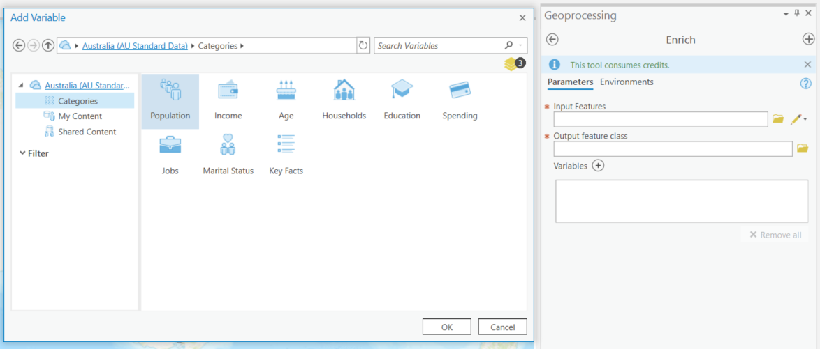

You could use the Enrich tool in ArcGIS Pro and use your zipcode polygons as an input. The tool does consume credits though. If this won't work for you let me know and I'll give you some other ideas.

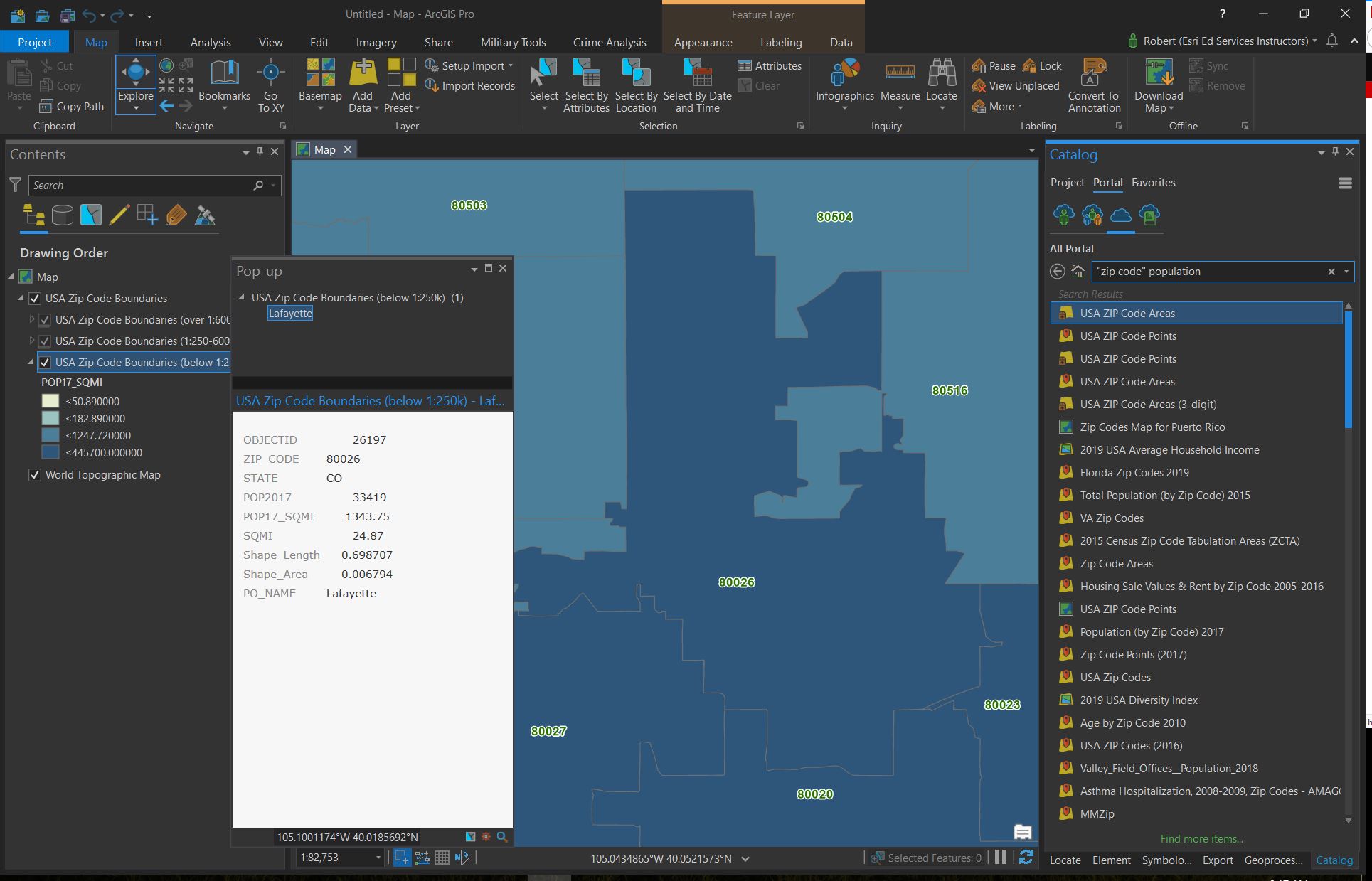

Chad - using ArcGIS Pro, I opened my Catalog Pane, clicked on Portal and finally the Cloud.  From there, I searched for "zip code" population and the first result USA Zip Code Areas (2017) I selected and added to a new map view.  In the map view, I searched for a zipcode, zoomed to it, click a Pop-Up and in the attributes there's a field Pop17_SqMi that might work for your purposes.
