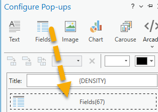

In the Configure Pop-ups pane, make sure that the Fields are added. This is the default but might have failed.

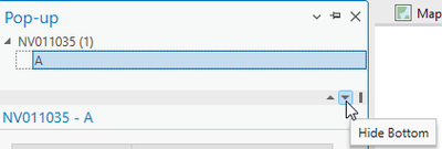

I inadvertently clicked Hide Bottom in the Pop-up pane and had to click it again to restore.

The Pop-up pane is divisible into two parts, either horizontally or vertically. The "divider" is sometimes at the bottom or side of the pane and doesn't stand out color wise. Hover the cursor over the darker bar at the bottom of the pane and the hide and split icons should appear. Drag the bar up to expose the contents of the lower part of your pane.
hduong
I hope you find solution, here is what I found. Mouse over the bottom of the pop up window, it will shows the Hide Bottom.
