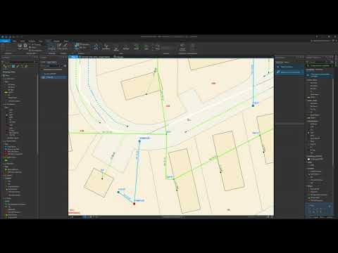

Hello,
I am having an issue with ARCGIS pro.  I have over 100 arcgis files saved onto our server and have been struggling with an issue I cannot figure out.  After opening up a ArcGIS Pro file within 1-10 minutes, every time I draw a new shape line onto the map, the line disappears after a few seconds or minutes.  This usually happens after I "save edits".   Sometimes the line is visible, but I am unable to click and highlight the shape and eventually it will disappear.   For existing shapes already on the map, whenever I edit the vertices or attributes, the edits are reverted back to its previous state.  In order to stop this from happening, I would have to close and reopen ArcGIS Pro so that I can create new or edit the shape.  Everything will be fine, but after a minutes or so the issue would happen again.   I noticed that it barely happens with a fresh new map, but after a while adding multiple growing amounts of drawings, the issue happens quite often.
Does anyone know what issue this is and how can I fix it?
Update. I have added a video below showing the issue.
https://youtu.be/Z2IzXmcnRSQ
Notce, I try to change 28.00 to 29.00 by editing the attributes, but after being saved, it reverts back to 28.00.  Secondly, when I try adding a few lines, the lines disappear and evidently shows on the attributes tables.  Lastly, when I try to delete the line, it returns after I save.
Uploaded by Julienne Jose on 2021-03-23.

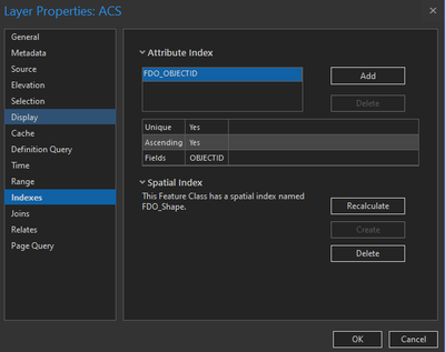

It also sounds like it could be related to the spatial index. Have you tried rebuilding the indices for the layers?

Open up the layer properties, go to Indexes, click Recalculate. No guarantees it will work, but it's another thing to try.

Thank you, but no luck on this one.
Ed209
This problem has randomly plagued me for years. Your solution fixed it.
