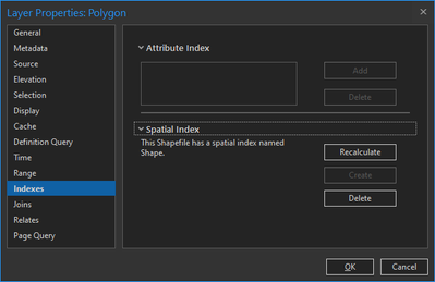

JohnWatt
Try deleting the spatial index.  With shapefiles you may also want to check there are no 'lock' files belonging to someone else - might be fighting someone else for write access on the network.
JuddStattine
Just tried it but same issue happens.  I posted another video of what error messages I am receiving.
