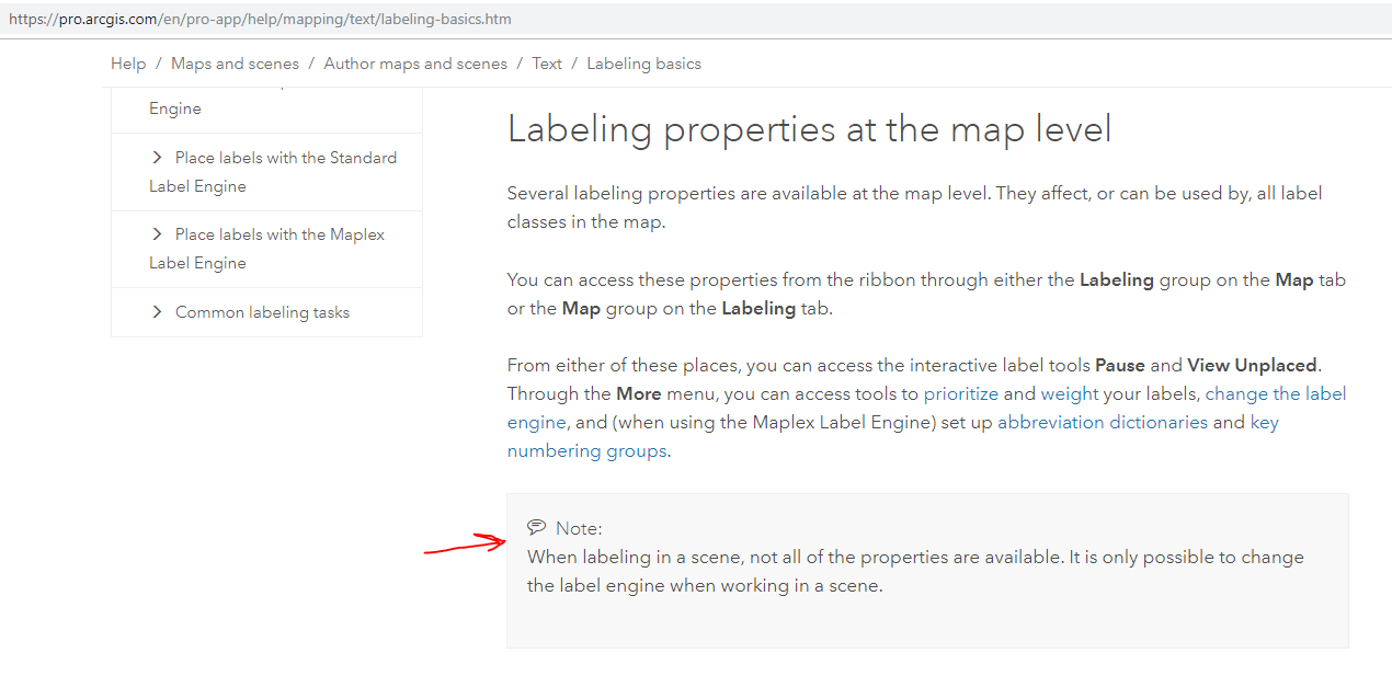

That is an Idea in the ArcGIS Ideas space.  Here is the documentation describing this as known behavior
https://pro.arcgis.com/en/pro-app/help/mapping/text/labeling-basics.htm
So, the idea that has been submitted would be to allow for more control over labeling properties when working in 3D.
