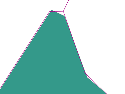

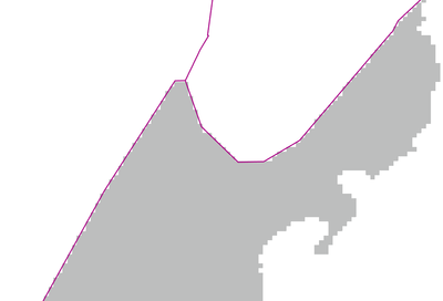

As expected, the perimeter of the resulting polygon does not perfectly match the original:

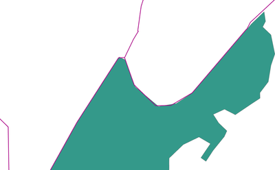

How can I clean up the polygons I've created so they match the boundaries of the original polygons? If there were only a handful of them, I'd just do it manually using trace tools, but with 350+ polygons, this isn't feasible. I also cannot take the original polygon geometry and apply it to the generated polygons, because that'll defeat the purpose of what I've generated (green polygon is the low-lying area generated from the selected polygon):

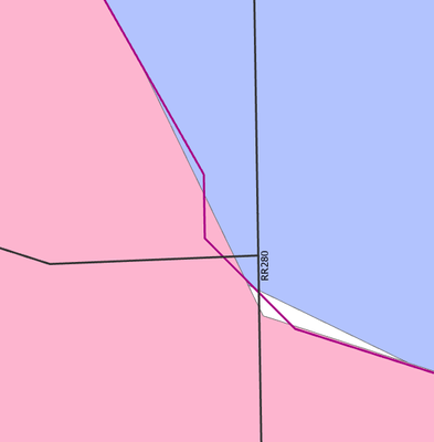

I'm generating these polygons to assign specific sections of road as 'low lying', but along the polygon edges, there are some spots that will be missed just because the geometries don't 100% line up. In this example, the purple line is the original polygon geometry, and the blueish and pink areas are 2 of the generated polygons. In theory, the grey RR280 vertical line *should* get split at the purple line: Everything above will be called "Type A" and everything below will be "Type B".

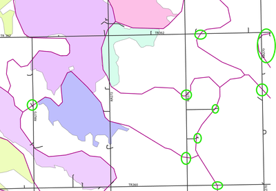

The problem is that I can't use the purple line to split the road line because I have way more spots where the road crosses a purple line without a low-lying area than I have spots that do have a low-lying area. I put green circles around areas the roads would split where I *don't* want the roads to be broken up:
If I just use the polygons I generated, I'll end up with errors in spots like that first picture where the section of road going through the gap won't be designated as a low-lying area, even though it should be. In that example, I'll end up with an unclassified 3.25m line
