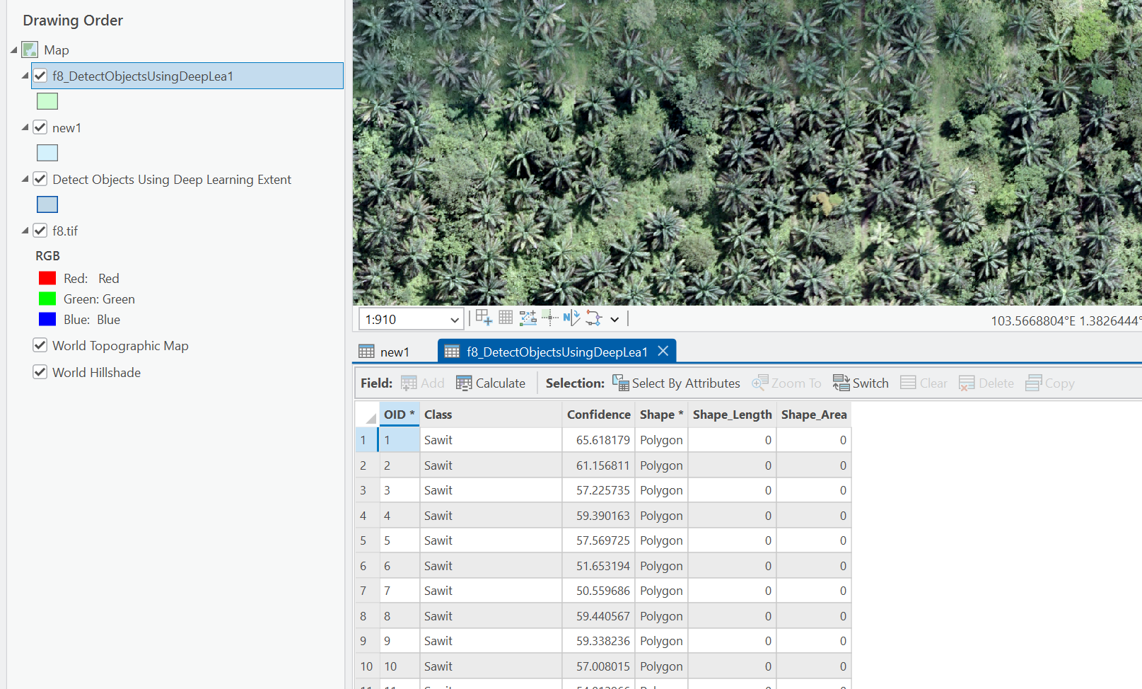

I’ve trained a deep learning object detection model using ArcGIS Pro 3.5.1. However, when I try to apply the model to raster data, the result comes out blank — no detections at all.
Interestingly, when I run the same model on ArcGIS Pro 3.4, it works perfectly.
Has anyone experienced this issue with version 3.5.1? Could this be a compatibility issue, or is there something I might be missing in the configuration?
Any insights or suggestions would be greatly appreciated. Thank you!

However, when I use the model to detect objects, the output appears blank. The attribute table is generated, but the Shape_Length and Shape_Area fields are empty, and no visible features appear in the layer — as shown in the screenshot I attached.
Any idea what might be causing this in ArcGIS Pro 3.5.1?

I am having a similar issue. After running the Detect Objects Using Deep Learning tool I get the Shape_Length and Shape_Area fields as zero for all the features and none of the features appear on the map.

Hi @J_Henry@NicholasSpencer and @alaminsuryarachman, I am able to reproduce this issue empty geometry issue happens when the input raster coordinate system is in Geographic Coordinate System (i.e.4326 ), for the time being can you please reproject the input raster to Projected Coordinate System (i.e. WGS 1984 Web Mercator (Auxiliary Sphere), NAD 1983 StatePlane California V FIPS 0405 (US Feet) and NAD 1983 UTM Zone 11N) and use it to extract the features using the deep learning model.
