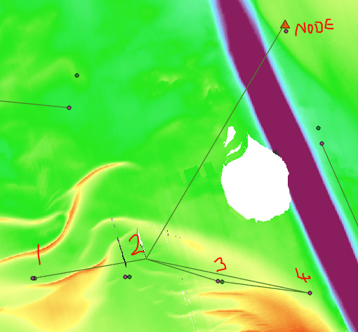

Q2 - Is there a way of, similar to the above, is there a way to connect the below drains in the configuration: 1-2, 4-3, 3-2, 2-Node.  It currently seems to connect 1-2-3-4-node but drain 2 should be a branch.  I also have the same issue with the branch not connecting to the node as per Q1.  This is all on the same map.

you need and origin and destination point for each segment
node - 1, node -2, node-3 etc
or however you intend to formulate what you need
