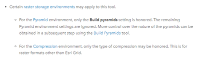

if you've picked Minimum and say 3 points with values 5,6,7 fall within a raster cell, then that cell will be assigned a value of 5.
Have you looked at How Point To Raster works
AmyOKeefe
Yes but where does the nearest neighbour come in with the pyramids?
I'm confused by the gridding process which creates the raster
