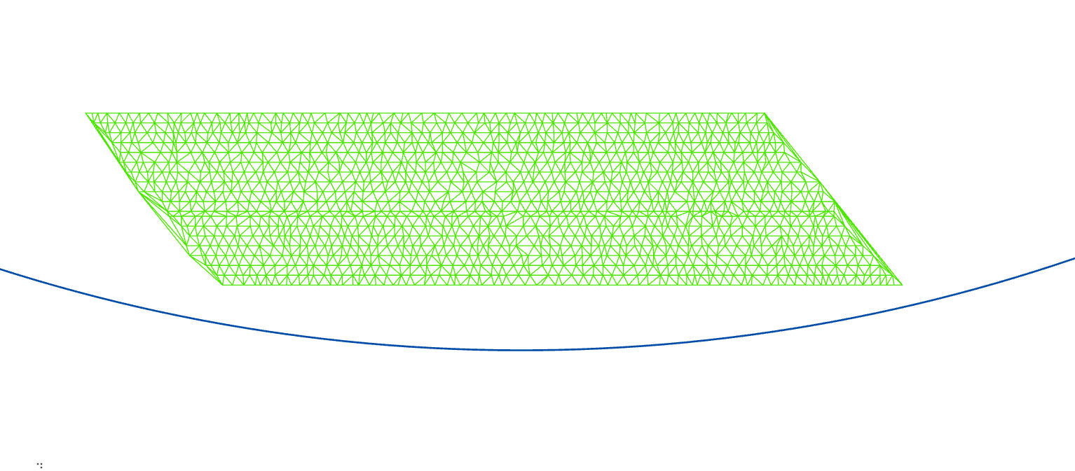

In CAD, I can import a text file with XY points and plot them along the curved line preserving the offsets between the points. I can then triangulate them to create an elevation surface.

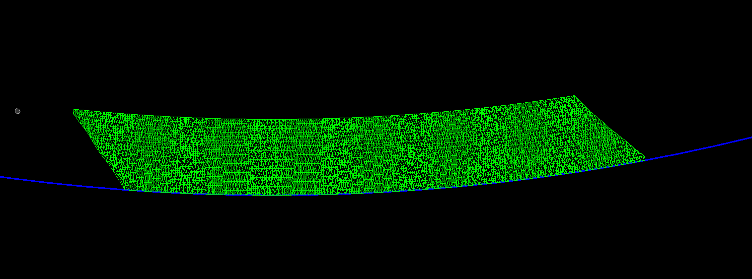

I have tried to replicate this process in ArcGIS Pro but could not find a way to plot the points along the curved (or straight) line. I used XY Table To Point and tried to align them to a curved line but couldn't find a way to preserve the offsets between the points. Is there a way to do this (or a workaround/different approach) in ArcGIS Pro?

CAD:
ArcGIS:
