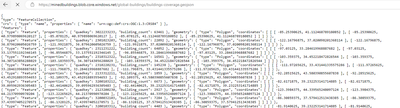

Hi Greg, I just discovered the site and github. When I click download GeoJSON I the json as below but I'm not sure how to specify state or even how to download it, it just opens in a browser window with no option to download?
