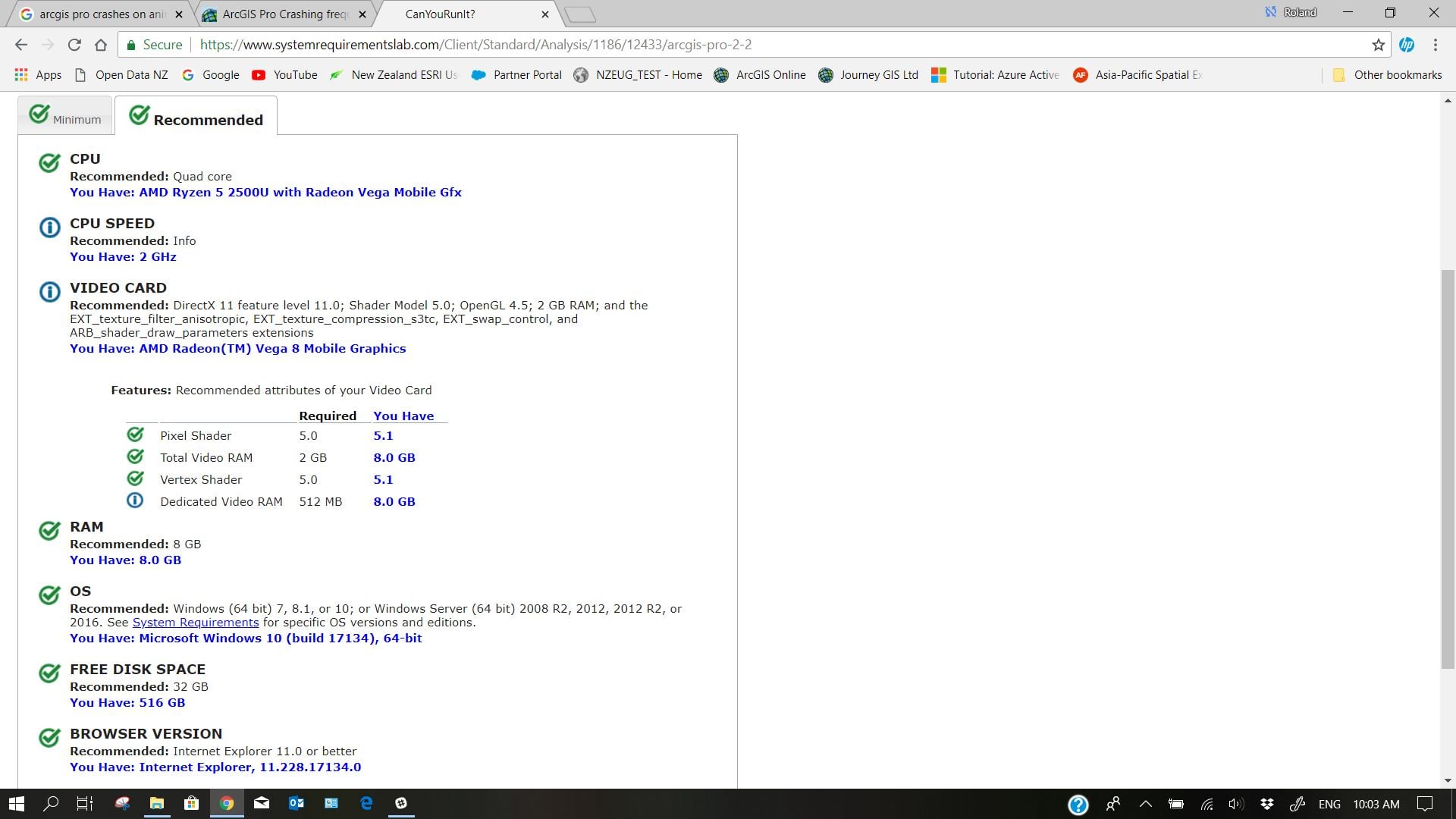

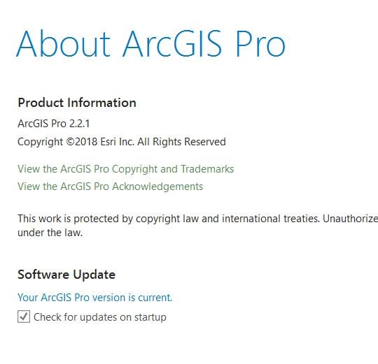

Version of Pro
I have seen others ask this question and be directed to run Can You Run It?
I have done this and my pc seems to be more than capable of running ArcGIS Pro.
CanYouRunItCapture
I have no idea why I can't export an animation - I have tried both mp4 and avi formats and all available settings e.g. Draft, HD720, YouTube and HD1080.
No matter what setting or format I choose it crashes every-time.
Even when I try to post an error report, that crashes - I have attached the error report from the last crash.
Anybody know why this is happening.

In addition to Kory's response, one thing I've seen that remedy's many AGP crashes (particularly 3D) is to update the video card driver directly from the cards manufacturer.  From your "Can you run it" report, I'd recommend you go to AMD's website, search for and install the latest driver onto your PC.  Once completed, try to rerun the animation workflow.  Does AGP still crash?

Following the advice from rleclair-esristaff I updated the driver for my video card directly from AMD.
This seems to have solved the problem, although I can still only export very small projects - it seems that as soon as there is more than 500 frames in the output AGP will crash. This is regardless of the output quality.
