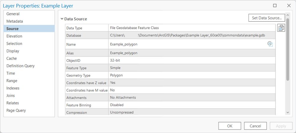

Unpacked layer package (.lpkx) contentsUnpacked layer package (.lpkx) contents
Depending on the compatibility of your source data with ArcGIS Pro 2.x or 3.x, you'll get a few items included.
The p20 folder contains data and layer files compatible with Pro 2.x and p30 contains copies compatible with Pro 3.x. The commondata folder contains data for both Pro 2.x and 3.x but often you'll find a copy of a file geodatabase in the p20 and p30 folders instead.

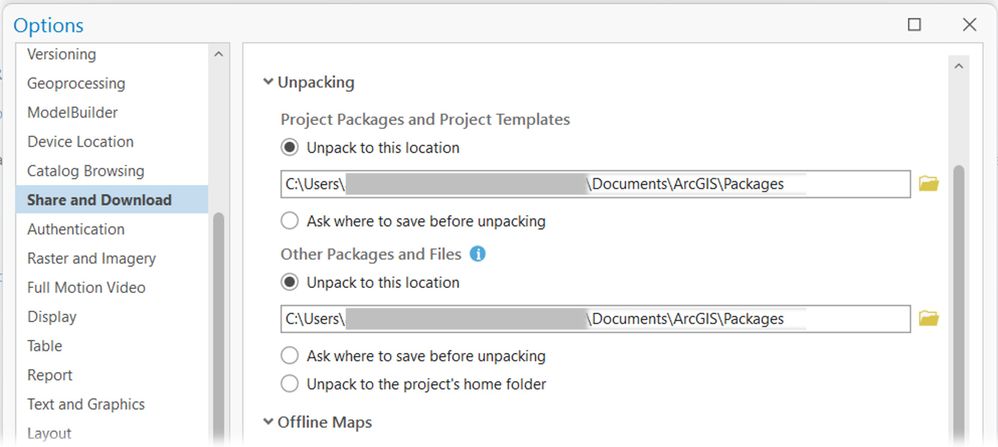

When you open a layer package or add it to an existing map, ArcGIS Pro unzips or "unpacks" the included data into a folder. By default, it will go into your user folder Documents\ArcGIS\Packages as shown in the screenshot above. In the Project > Options > Share and Download menu, you can also set a different folder, automatically unpack to the current project's home folder, or ask you each time to select a location.
Unpacking options on the Share and Download section.Unpacking options on the Share and Download section.
Wherever it unpacks the folder, it will add the compatible layer file(s) to your map. They will point to the applicable data source from the unzipped package. In the case of Enterprise (SDE) or UNC (\\local.network\shared\) paths, users have the option when creating the package to create layer files which point to the original source data or instead create a copy of the data inside the package.
You can check the layer properties in the map to see the data source for each layer, or change the options above to choose something more convenient for you to find. I personally like the "Unpack to the project's home folder" option as it saves the data and layer files neatly within the project where I'm using them and I don't have to manually browse to the folder each time. The example I've used in the screenshot is saved at the default "Packages" folder location.
