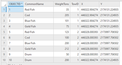

Sorry to ask another question, but I'm trying to picture the data: each tow will have many records in the table; one for each fish type?  For example:
If this is true is this a table linked to a point feature class or is it a feature class with multiple points at the same location.. I.E. stacked on top of each other, one point for each fish type at each tow location?
tomsanfilppo
Its just like your example and its  a feature class with multiple points stacked on top.

Original Data (SQL Table, could have been imported from .csv):
Use the "Create Database View" geoprocessing tool using this code

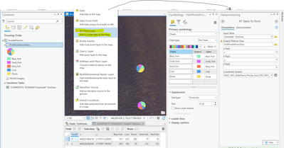

Then you can use this view (TestView in my case) to create a new query layer in your map by dragging it onto your map's table of contents.  The new query layer looks like this:
You can now use the add data tool's X,Y point conversion tool to bring the data into the map in such a way that it can use Pie Chart Symbology
As for the weights being in text, you can make the conversion when you make your database view using the SQL CAST() function... something like this should work:
