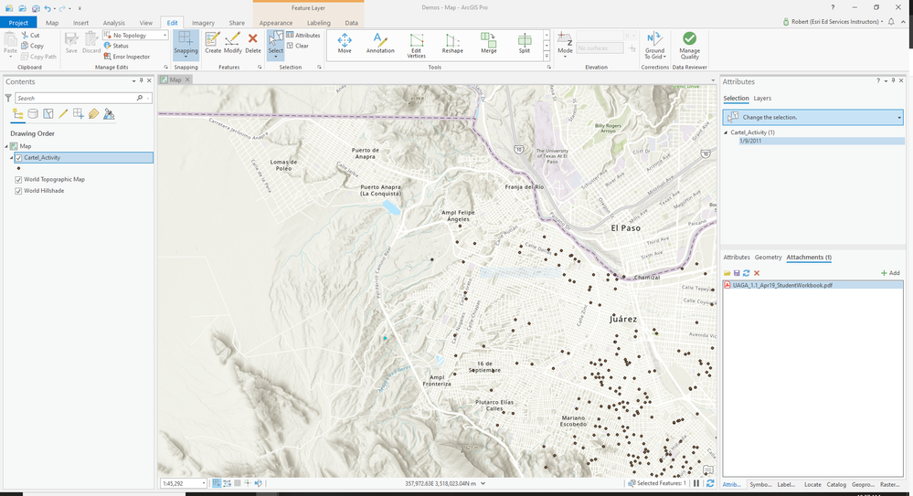

Okay - sorry - had to ask!  🙂  So I enabled attachments on a Point Feature class, clicked the Edit tab, added a *.pdf to the selected point, saved my edit.  Then to test, selected the same point, went to the Edit Tab and clicked Attributes in the Selection Group.  This opened the Attribute Pane.  Clicked Attachments and saw my *.pdf.  Double clicked the *.pdf and it opened in Adobe Reader.  I'm using ArcGIS Pro. 2.7.2.
