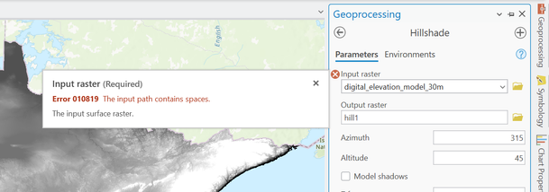

I've been running into an issue where I'm receiving an error about spaces being in the raster pathname, but there aren't any spaces:
Any thoughts? I've tried move the raster to other folders, and it still shows the same error.

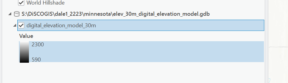

The list by source tab in the table of contents does show the true path of the parent workspace (GDB/folder) but will still show the layer name below - rather than the filename as it appears in Catalog.  I'd double-check the Catalog window and see how it appears within the GDB.
If it looks ok, then I'd try to shorten the filename to test, or export to a TIF and retry.  Even export a small subset as .tif to test with.

select the folder icon beside the "input raster" line and navigate to the raster and select it.
apparently this is an ongoing problem and this was one solution for some, but not for many.

Instead of storing the output raster dataset as fGDB raster, try creating the raster outside of the fGDB and save it as *.tif file.  Does the error message persist?
Related, I would also try the fGDB storage route on your C: drive in a temporary directory like C:/temp/test.gdb and call the output digital_elevation_model_30 and see if the tool completes with or without the error message.  If without then I wonder if the bigger problem is the name of the S: drive having space in it...maybe.

I was able to resolve it!
Originally, I was trying to save the output raster to the fGBD in the S: drive, but that wouldn't work, so then I was trying to just save it (the "hill1" output) to a regular folder in the S: drive so see if that would fix it. Sometimes that will work for me, but didn't in this case.
I was able to get it to eventually work by -->
Starting a new ArcGIS Pro project > exporting the raster out of the fGDB to a regular folder in the S: > renamed it to "mn_dem" > then I was able to generate a hillshade from the new version without a problem!
I wonder if the issue is the fGDB in the S: drive (which is a Windows Network Drive). We have really limited options at our organization for storage, so it's only Windows Network Drives or Google Drive. If it's vector data, I can actually get all of the tools to work just fine with fGDB, so not sure exactly what was causing the problem.
It's also possible that the name of the fGBD was too long and that could be the problem (maybe?)
