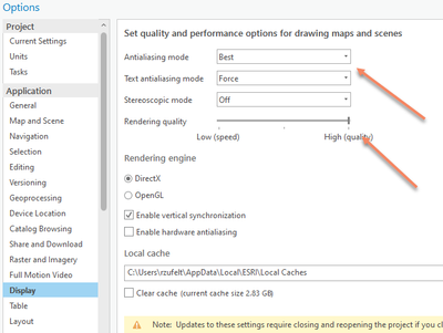

Have you checked you display/antialiasing settings?
My jagged lines went away when I turned on antialiasing and made sure rendering quality was high.
