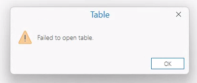

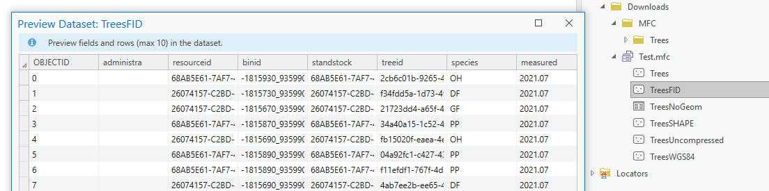

Ive created a multi-file connection (mfc) to a directory with some parquet files in Pro 3.1.3

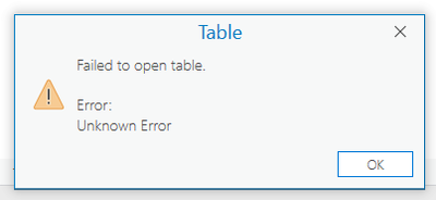

The mfc creates fine and I can preview the layer (see below) but when I add the layer to a map I get no geometries and if I open the attribute table I get an unknown error.
Pro recognizes the geometry column fine according to the layer properties.
Ive tried;
- Different projections (original data is not in wgs84)
- Adding an objectid
- Removing the geometry column
- Removing the compression
But I will get the same error and no geometries.
TrevorH_OPE
@DerekGourley finally solved (kind of), Pro seems to have issues with the geometry column.
I exported the data as Parquet minus the geometry column and that worked fine in Pro.
If I export and include WKB or WKT I get the error/crash behaviour described above.
What I did instead was calculated a field new field as GeoJSON and exported as Parquet (with no geometry column).
Pro recognizes the GeoJSON field and works as expected - MFC is happy, attribute table is happy and draws in the map.
Do you have any guidance on supported geometry columns?
Pro suggests that WKT and WKB are supported?

Thanks Dan. I have seen that post. I don’t have an issue creating the connection to the data. It just doesn’t draw and throws an unknown error when I try to open the attribute table. Pro recognizes the data (fields, geometry type etc) and can preview it fine though.

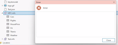

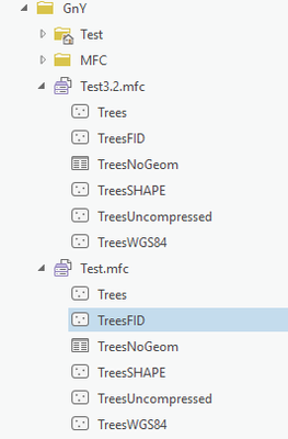

Thanks for the reply @DerekGourley unfortunately Pro 3.2 is no better even fully patched.
The mfc connection doesnt even list the layers...
The connection under 3.1.3, shows the layers
Pro 3.2 doesnt list anything when you try to expand the connection - notice the arrow is not visible even though I have expanded the connection in Pro

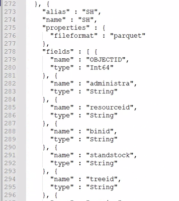

If the arrow does not appear, could you please try right-clicking on the MFC in the Catalog and then selecting the “Show in file explorer” option, followed by opening the .mfc file in a text editor. With the .mfc file open in a text editor, does the file contain a list of datasets or is it an empty list ([])?
The image you shared has two MFC files, was one of them re-created using Pro 3.2? I might suggest also trying a MFC file name that doesn’t have a period in it, such as “Test_32” or “Test_3_2”.
If the MFC file was re-created with Pro 3.2, did the messages from the GP tool (or the MFC UI, depending on how it was created) show that datasets were successfully identified? When you originally created the MFC file with Pro 3.1.3, did it show that the datasets were successfully identified?
If the MFC file was not re-created with Pro 3.2, can you try re-creating it and let me know if it lists any datasets that were successfully identified? Would you be able to share any messages or warnings that you see?

TrevorH_OPE
Hi @DerekGourley
I believe the folder structure is correct and the files are not encrypted. As mentioned they previewed fine in 3.1.3. The 3.1.3 and 3.2 are different machines. All data is local. The MFC connections were recreated in each version of Pro.

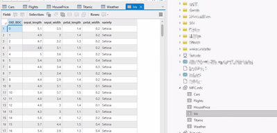

For sanity I downloaded the samples from here;
https://www.tablab.app/datasets/sample/parquet
These work fine in Pro 3.2 except for the Iris file which has periods in the column names. If I remove the periods it works fine in Pro.
This is what they look like in Pro

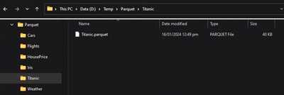

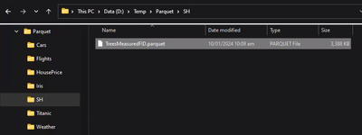

TrevorH_OPE

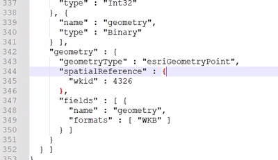

So if I add one of the Parquet files I am testing to that structure
And then try and Sync Pro does this
The MFC has updated though
And the geometry has been recognized
If I close and open the Pro project again Pro just crashes, I have submitted an error report.
If I delete the Parquet file but dont sync the MFC then Pro opens the project fine and the folder is shown in the MFC (but there are no files behind it).

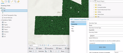

TrevorH_OPE
