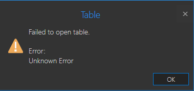

When I try to add the data to the current map no data is displayed. When I try to open the attribute table I get the following message

Currently, parquet-based big data connections cannot be added to the map (including opening the attribute table), visualized, or used directly in tools that are not part of GeoAnalytics Desktop tools. To use them in the next step of your analysis or visualization, first run a GeoAnalytics tool, such as Copy Big Data Connection, to save the results as a shp of fgdb, then you can do further analysis or visualize them.
There are notes on the support here: https://pro.arcgis.com/en/pro-app/latest/help/data/big-data-connections/use-big-data-connections.htm... - see the notes under visualize and use BDC datasets in analysis. I'll update those notes to include the suggested workaround and clarify you can't open the attribute table.

Hi @dvonck,
Expanded support for Parquet has been added in ArcGIS Pro 3.2. Big data connections are now called Multifile Feature Connections (as of Pro 3.0) but your existing bdc connection file will still work. Datasets in the bdc/mfc connection based on parquet files will now display when added to a Pro map, and can be used as a read-only input data source for most geoprocessing tools.
