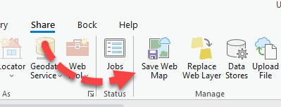

@WernerStangl_ehess  ArcGIS Pro may provide functionality that can help for your use case.  If you open a webmap  (insert tab --> Import Map --> My Content (Insert a webmap that you own)  You can use "Save Web Map" button on the Share tab to modify an existing webmap.
https://pro.arcgis.com/en/pro-app/latest/help/sharing/overview/save-a-web-map.htm
