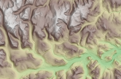

Hi all,
I want to use OS Terrain 50 and have the colour shading that the OS say is possible with the data. I have downloaded it but cant work out how to do it. Can anyone help? The image below is what I want my mapping to look like or similar.
I have downloaded the shapefile(Contours version) which contains contour polylines and height points.
Thanks
Dave

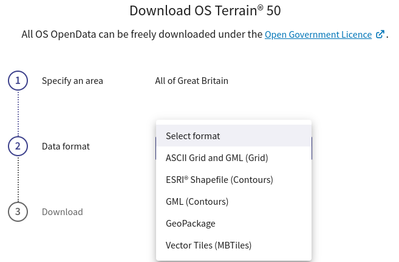

Download the ASCII grid format
Use this script to convert the downloaded zip file (don't unzip it) to a GeoTIFF
Then create a hillshade and overlay another layer (same data) with semitransparent colour symbology or use a shaded relief raster function.
