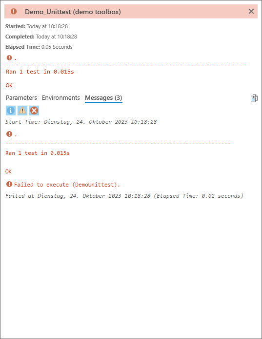

When running the Python Tool in ArcGIS Pro I get the following result:
So from the screen dump above, I conclude the Unittest performed as expected (OK).
But why is ArcGIS Pro telling me erroneously  "Failed to execute (DemoUnittest)"?

the class constructor unittest.TextTestRunner has an argument stream, which can be initialized to sys.stdout. In this case the problem with failing tools does not exist.
Luke_Pinner
MVP Regular Contributor
The default output stream for unittest.TextTestRunner is sys.stderr and I don't know and haven't tested, but  perhaps ArcGIS notices this and assumes there's been an error?
BernhardEhrminger
BernhardEhrminger
thank you Luke, the situation is like you pointed out.
