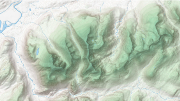

Hi all,
I want to use OS Terrain 50 and have the colour shading that the OS say is possible with the data. I have downloaded it but cant work out how to do it. Can anyone help? The image below is what I want my mapping to look like or similar.
I have downloaded the shapefile(Contours version) which contains contour polylines and height points.
Thanks
Dave
Luke_Pinner
MVP Regular Contributor
Download the ASCII grid format
Use this script to convert the downloaded zip file (don't unzip it) to a GeoTIFF
Then create a hillshade and overlay another layer (same data) with semitransparent colour symbology or use a shaded relief raster function.
