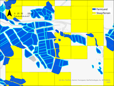

Thank you for your replies. I'm including a visual sample to better explain the "100m mesh polygons." In the attached image, the yellow areas represent the steep terrain polygons, each approximately 100m in length and width. The blue areas denote the farmland polygons. For simplicity, the image showcases a smaller section, but in total, the dataset comprises 50 million blue polygons (farmland) and 10 million yellow squares (steep terrain).
