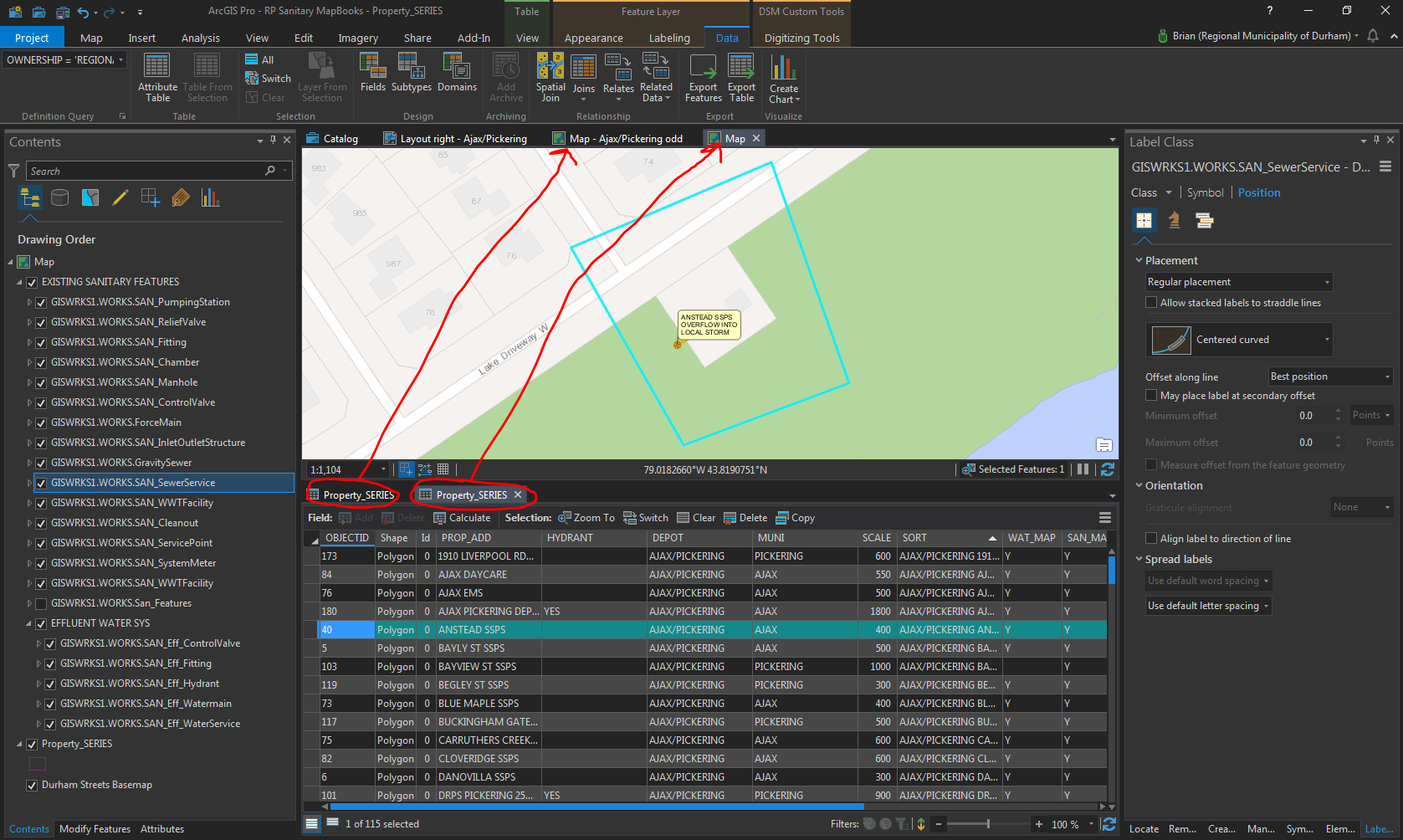

Is there a way to only show attribute tables for the currently active Map tab?  It becomes very confusing when you have multiple Maps in a project, and you are looking at attribute tables, but not really sure which one is connected to which tab.
See below....When I am on "Map", I only need to see the attribute tables that I have opened for that Map, but all the other attribute tables are showing.  Is there setting somewhere I can set to modify what shows??

In ArcGIS Pro I'm trying to find out how to only have attribute tables open for a Map that is currently being viewed.  I'm trying to take advantage of using multiple maps in one ArcGIS Pro project.  In ArcGIS Desktop I created several mxds, but in Pro i combined all these mxds into one .aprx.  These mxds had a layer that was the same name in each one, but each contained different data. For example, there was a layer called "MasterFeatureClass" in each mxd, but the data itself was different.
When I imported these mxds into ArcGIS Pro it made it simpler in the fact that I didn't have to open each mxd.  The problem is that when I open up "MasterFeatureClass" for a particular map that is on display it still stays up when I click onto another map.  It confuses me and I think this is the table for the map that I switched over to.

It isn't currently possible to do what you're suggesting.  The only way that I can think of to close the tables related to a map when you close the map would be to place them in the same tab group.  Then, when you close the map, just close the tab group.  But I can see already that it isn't really a very functional way to view the map and tables associated with the map.  Anyway, just wanted to share that you might play a little bit with views and grouping to see if you can find something that works for you.
So that would make this a very good candidate for the ArcGIS Ideas‌ space, if one of you is interested in submitting an idea.
