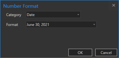

Just wondering if you set the Number Format for a specific field, should that also be reflected in the Labeling of that field in the map?
For example, I have the Number Format for a DATE field set to this:
But in my map it just shows the default format.  In the table it is showing the proper format though.  Is this a glich, or just how it works??
WendyHarrison
ah - vbscript, jscript and python will respect the field formatting that is set.  You're using Arcade (the default label expression language in Pro), which pulls the raw feature and then gets the field value - it doesn't go through the field formatting.  This method is better in the long term as it is more portable for the expressions.
