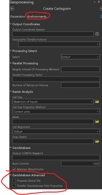

Hello Katy, It looks like in the Geoprocessing Environments tab, in Geodatabase Advanced, tab you can select Preserve Global IDs and Transfer Geodatabase Field Properties. Perhaps that's what you're looking for?
Layer Slayer
KatyAppleton1
Thanks for the reply but I just tested and this doesn't fix the issue. While my census data has a unique identifier for each zone, it is not a Global ID in the ArcGIS Pro technical sense, and Field Properties are not relevant.
