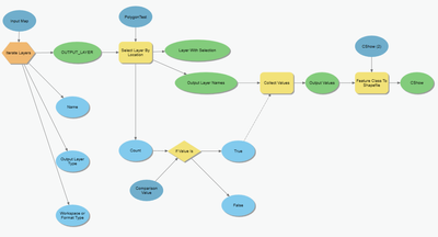

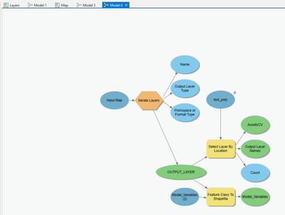

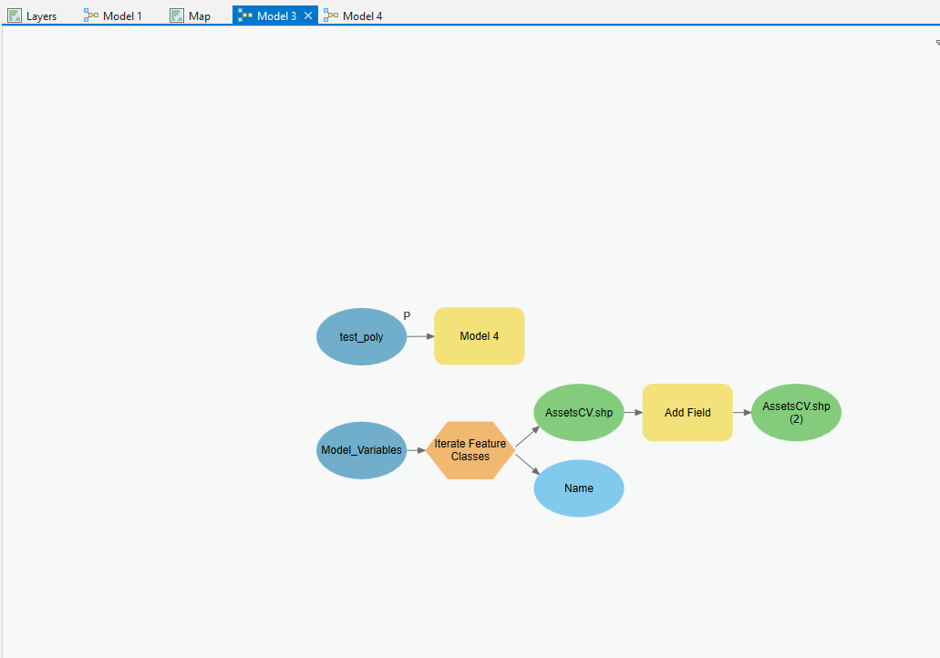

Hello,
I have created a model which iterates through some feature layers, makes a select by location, and exports the selected features into a folder as shapefiles.
I have also created a second model which is in theory supposed to run the model above, and then iterate through the the shapefiles and add a new field to each featureclass.
At present, my model does not run the former model, and I do not understand how to edit the python code so that I can run both models sequentially.
I have attached screenshots of the former model (Model4) and latter model (Model3), and the python code exported from the latter model.
Model4:
Model3:
Python Export:

Here's the thing about iterators in Model Builder.  They run everything in the model, regardless of where that tool or sub model is in relations to the Iterator.   For example, my brain would tell me that since model 4 is running before the iterator is fired in Model 3, Model 4 would run once and then Model 3's iterator would loop as many times as necessary, but that is not the case.  In your model 3, each time that iterator loops Model 4's iterator will loop.
One way to deal with this is don't use a sub model containing an iterator as an input into another model that contains an iterator.  For example; have a third "Main" model that calls Model 4 and then calls Model 3 rather than calling Model 4 directly from model 3.

- When I'm in the model builder and I can't directly connect Model4 to any process as it isn't a variable. For reference, it doesn't seem to me that the function from Model4 is being used in the code for Model3. I'm not sure how I can signal to Model Builder that in essence I would like the function from Model4 to run prior to the function created for Model3.
This is perhaps due to my lack of knowledge of how the arcpy.EnvManger parameters work - if anyone has any tips on that it would be appreciated.

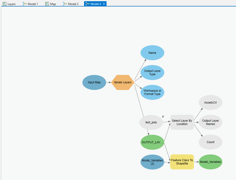

Looks like Model 4 did not validate.  That probably indicates an error in Model 4.
I'm guessing the OUTPUT LAYER parameter from Iterate Layers in Model 4 should not be used as input into the Feature Class To Shapefile tool.  Rather the output of the Select Layer By Location tool should feed the Feature Class to Shapefile tool in Model 4.  Something like this:
Also, I agree with @RhettZufelt.  I don't see why two models are necessary.  You can add the attributes to the shapefiles as they are created, but if you do want to create the shapefiles first and add the fields later you will need 2 models (since their is a limit of one iterator per model as you know).... To use two model try making Model 4 a precondition of Model 3.
OscarFitzpatrick
That's very helpful thank you! I've revalidated** Model4 (for ref:)
and re-added the new validated model to Model3 which is now adding it to the body of Model3's main function (for ref:)

I can see that Model 4 is being run recursively in the main body of Model3, making the processes very lengthy. I'm unsure if there is a way to alter the code of the Model directly, but I would like Model4 to run before the for loop in the main body of the Model3 function.
After I run these processes, I would like to iterate through the created shapefiles and export their tables to a .csv file, and then colate these .csv's into a single file.

KimberlyGarbade
OscarFitzpatrick
That's done the trick! I've taken Model4 out of Model3 and run both Models in a main Model instead.
That's excellent info, I couldn't find anything similar on the Esri documentation. Now I can move on to trying to collate all of the tables into one export - thanks again!
