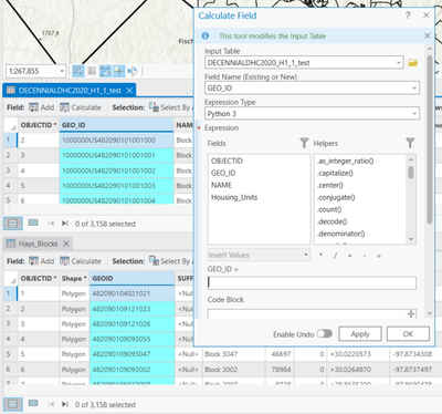

Hello, I simply need to truncate (remove) some leading characters with the Field Calculator, but can't recall which Python command I need to use. The purpose is to create a common field to Join Census Data with TIGER. See below:

Depending on your naming scheme:
# if it's always the same start:
!GeoID!.replace("1000000US", "")
# if the number can change:
!GeoID!.split("US")[-1]

Ah yes, "Replace" -- thanks!
