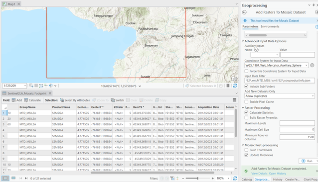

By any chance, do you have a file with extension .xml or .safe in your downloaded dataset? It seems that ArcGIS Pro uses this metadata when creating mosaic datasets. It looks like in this image

Thanks. I looked at copernicus.eu to get my imagery, but ultimately decided to go with sentinel-hub's python api (though the actual api call looks identical, from what I can tell). sentinel hub just sent a tiff and a json copy of the request params, nothing else.
I did manage to get the multidimensional dataset working though. The video wasn't very helpful, but this page (https://pro.arcgis.com/en/pro-app/3.1/help/data/imagery/create-a-multidimensional-mosaic-dataset-fro...) mentions that you can manually create data to act as the "variable" (I put "spectral" into "ProductName" for example) and I can use calculate field to complete the AcquisitionDate from my filenames. After that, "build multidimensional data" worked fine.
